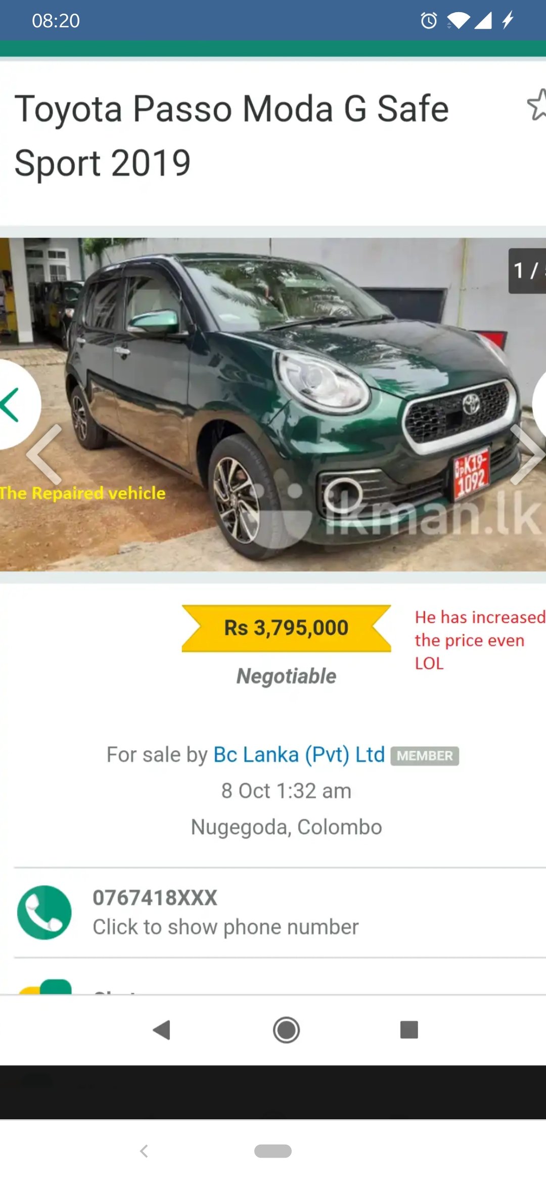

අලුත් recondition වාහනයක් ගන්නවානම් ‘’Best Change Lanka (Pvt) Ltd ’’ එකෙන් ගන්න කලින් හොදට check කරන්න. මොකද accident වෙච්ච වාහන, accident free කියලා fake documents හදලා විකුනනවා. මේ කොළ පාට Toyota passo Moda G 2019 car එක accident වෙලා චැසියත් repair කරලා. මම ගන්න කලින්  Toyota Inspection දාපු නිසා බේරුනා. Inspection report, reservation payment invoice බලන්නකෝ attach කරලා තියෙනවා පොස්ට් එකට.
වාහන අලෙවිකරු - O**** T**********
Quick site seller Name - Bc Lanka (Pvt) Ltd.
Location - Delkanda
If you are purchasing a new reconditioned vehicle, please avoid the following car sale (refer attached images) and this guy named as O****. The car sale name is ‘’Best Change Lanka (Pvt) Ltd ’’. This sale is a home based one near Delkanda.

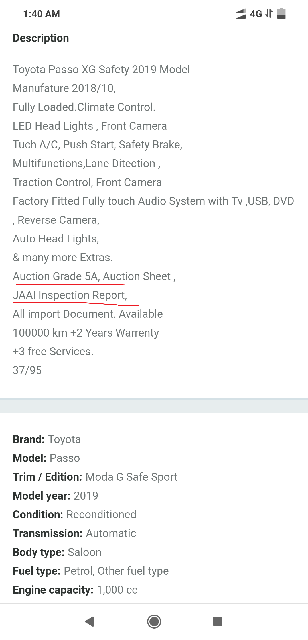

The vehicle that I inspected was a Toyota passo Moda G 2019 ( Refer attached images). According to the fake documents that this guy shows you and advertise, auction grade of this vehicle is 5 and it has JAAI certification also. And the documents says its accident free.

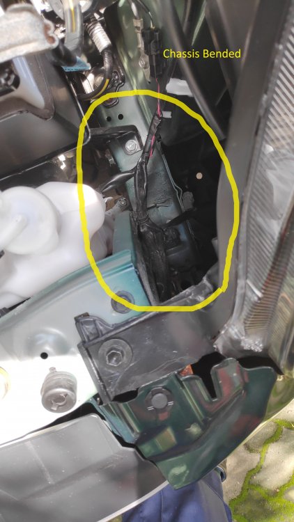

In the inspection, Toyota team found out that this car has caught up with a major accident and then has been repaired ( vehicle inspection report is also attached herewith).

Does anyone have any prior experience regarding this car sale? How come an accidentend vehicle have JAAI certification and Auction Grade 5?

@Lahiru Sachintha....it is common knowledge that 99% of car importers/sellers in Sri Lanka forge inspection certificates, turn back mileages etc...so nothing new.  These guys buy accident damaged cars from yards or R grade cars from auctions...fixes it up...puts it through inspection (which will show high mileages or accident damage or repairs, etc..) and then they make a forged certificate when selling :)

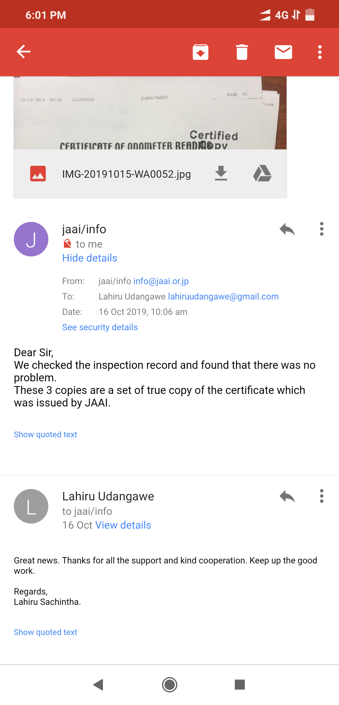

After this happend, for a different vehicle, I managed to get the JAAI certificate, certified as a true copy by contacting their hq. They do it for free. For people buying reconditioned vehicles, try this out too. They respond quickly as well.

Looking at the shape of this car, this is just a small freckle in comparison to some jobs that are being done to locally crashed cars lol.
even the airbags have not been detonated

The thing is..yes...the crash does not seem to be that severe....but it should be made transparent to the buyer so the buyer can make informed decision to either purchase it or walk away.

I'm not sure hit does it look like hes charged the buyer for a premium car? When it has been bought dead cheap in the auction,? Then botched up
Also I'm not sure of this model but certain parts of the sub frame, esp in the front are made to be replaced, they could have done it and made a transparent deal, since they went all the way
